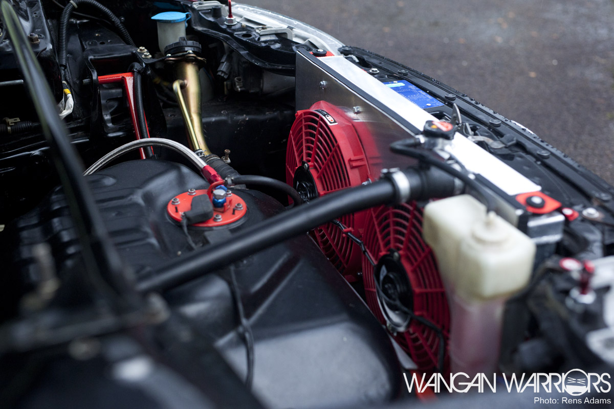

With the engine replaced to the rear in a car that wasn’t designed for it, you need to bring some weight to the front to have it all balanced out. As you can see, Bennie installed the fuel tank in the former engine bay and saved some money by using the original tank instead of buying a new custom example. Again he decided to customize a few things to make everything fit and operational.
