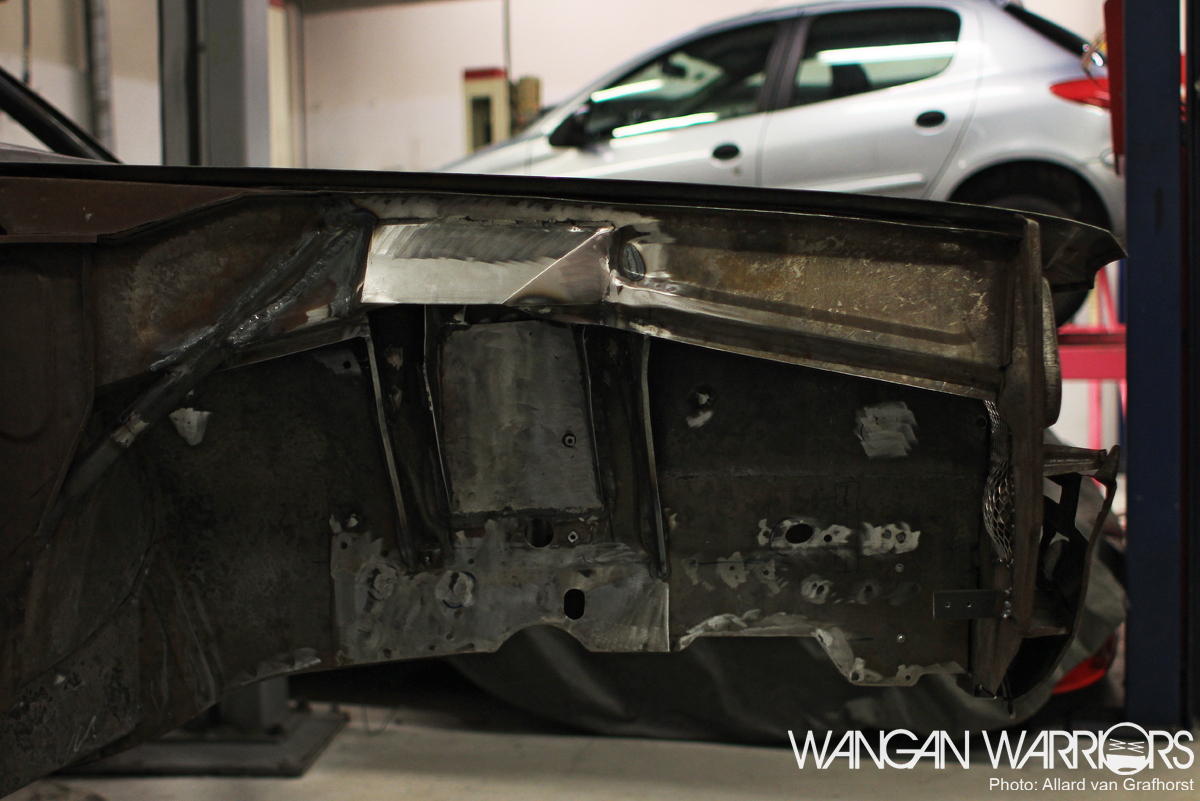

If you’ve read part two about project Hakosuka, you know that this car will receive a full drivetrain upgrade from a BCNR33. But equally important is the fact that the Hako’s chassis is getting a complete overhaul.
It’s been completely stripped, acid dipped, spot welded and strengthened.
Just about anything that could be done to make sure the more than 40 year old shell can handle all the abuse…
… the RB26 will throw at it, has been done. As you can see here, the sump has been modified to make sure it fits inside the tight engine bay.

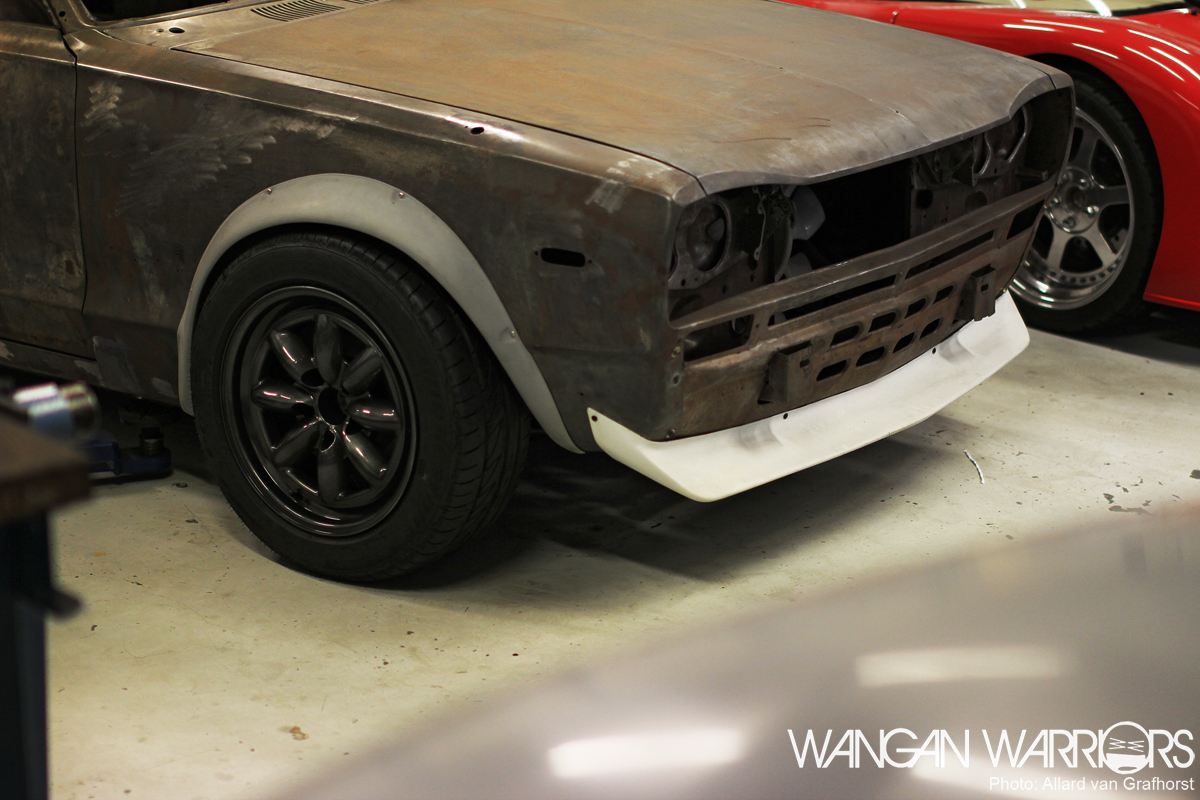

The guys at DBM engineering also received a package from the UK where Image Wheels produced a custom set of three piece wheels with hidden hardware, measuring 16 x 8J ET5 in the front and 16 x 9J ET0 in the rear. The owner opted for original Watanabes first but unfortunately they couldn’t deliver wheels in the required specs but luckily Image Wheels could!
The track width of project Hakosuka has been increased dramatically, thanks to the BCNR33 subframes and everything that comes with them so deep dished, low ET wheels like you see on many Japanese Hako’s weren’t really an option.
